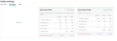

Sure, this is one site

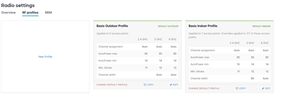

This is another where we have tried turning off 6Ghz and changing it to run with 2 radios instead of 3, none of the settings increase performance. With the MR33's we pretty much had everything set to auto and had no issues and good performance.
The only observation I would make is to avoid using an 80 MHz bandwidth for the 5 GHz band, considering you only have 6 available channels with that configuration.
If possible, also avoid using the 2.4 GHz band. Otherwise, I don't see any configuration problems.

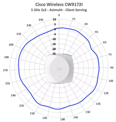

MarcP
jrhop
Building a reputation
Thanks @MarcP based on that I would interpret the CW9172I to be slightly better or at least the same as the MR33

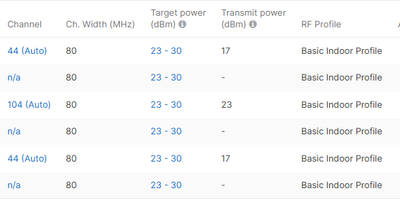

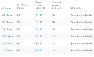

@RaphaelL Thanks, first one below shows a site where we tried to increase transmit power. Second one is from a site set to auto, same as MR33's were.
ww
I think 18dbm is the max for a 4x4 AP with beamforming on the UNII-1/2 channels. So if this is calculated with the auto setting it looks like you might need more AP's. To be sure you could do a site-survey. Were your mr33 also on 18dbm or higher?
The mr33 was 2x2 and was probably going to max 21 dbm.

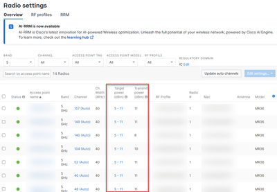

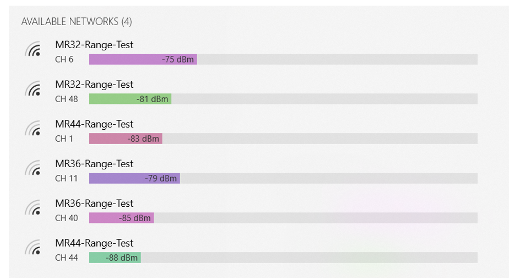

I found similar reduced range when moving from MR32 to MR36 and MR44.  Not hugely scientific, but I did a number of tests where I had one of each model AP (MR32, MR36 and MR44) located alongside each other with my laptop a distance away in an office.  My signal level was better with the MR32 versus the newer MR36 and MR44 models.  The AP speedtest on the AP management (my.meraki.com) also produced better throughput on the MR32 than the other newer models.  All power/channel settings to AUTO

Thanks for your input @pjc On some sites before we put in CW9172's we did deploy some MR36's and these were almost the same in terms of coverage with the MR33's. Therefore we assumed (wrongly) that the CW9172's would be the same or similar, but looks like we were wrong and the CW9172 do not perform as well.
