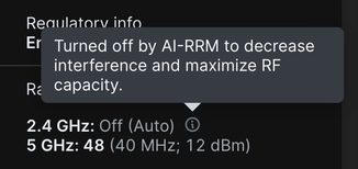

AI-RRM making dubious decisions
I have a network with 3 active APs in it and as you can see AI-RRM has disabled the 2.4GHz band on one of the APs.  There is zero interference from other people as I am lucky enough to not have any neighbours within 60m from any of the APs:
Ia anyone else using AI-RRM and how is it behaving for you?

cmr
I hadn't realised that AI-RRM was not early access any more so in order to maintain license compliance I turned it off.  Interestingly the 2.4GHz radio on the AP is still off and marked to be made as such by AI-RRM...  Not sure how to turn it back on without manually overriding the profile which seems odd!

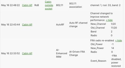

cmr
I found the event log, looks like the low client count leads it to disable the radio, coverage is not 100% overlap though...

cmr
The 2.4GHz radio did eventually come back on automatically along with a strange message that the hannel was changing from 11 to 1 even though it was 1 before...
