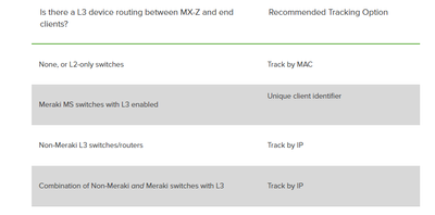

We were also seeing this issue after installing brand new MX250s in our environment. Some websites would be stuck at a white screen for more than 30 seconds on the initial load. After 30 seconds it would then go to a connection reset screen (which is the screen you would see if it was blocked) and then load the website eventually after about a minute. We upgraded the firmware to the latest (18.106) and we still had the issue. The fix for us was to combine the firewall and switch networks and turn on Unique client identifier under Security & SD-WAN > Deployment Settings > Client Tracking.

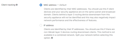

I have been informed by Meraki support that in our case, we have clients behind a non Meraki L3 device (our VPN)
and are using content filtering, and out client tracking is set to MAC address. (we use combined network dashboards.. like most users)
Meraki support has provided us a "solution" (that I don't agree with but get to that later) which is to split the network dashboard and set client tracking to IP address.
If you want to give this a go you can do this by going to Organisation -> Overview select the network where your clients are behind a non Meraki L3 device then select "Split network"

We finally solved this after a combination of upgrading to MX 18.107.2 and changing to "Unique client tracking", but your milage may vary.
Hey @JonP, glad you found a way to get it working for your team. Looking at the documentation for it, it does look like "Unique Client Identifier" fits our situation:
The problem I have is that on all my other sites that are functioning that have been upgraded to v18; they do not have "Unique Client Identifier" as an option. They are of similar model as the problem site (MX100):
Yeah if you don't have a full Meraki network it's going to be different for you. Meraki basically shrugged their shoulders when presented with the problem, and after pushing them for a resolution they suggested this. I don't recall the exact reason as they mentioned it when they were on the phone with my colleague @CameronS .

@Oderbang We were able to get it working by updating and switching Client tracking to "IP address." Thank you for your work on this and sharing the fix with the community.
