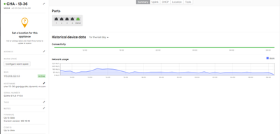

We have 2 remote sites using Meraki SD-WAN with Starlink as the internet. These two sites connect back to a Main site that has an edge firewall and the MX Concentrator behind that firewall. The trouble was with the remote site was not able to build the VPN tunnel from the remote site with Starlink back to the Concentrator.
Thank you ZachE768. I am facing exactly the same thing. The only difference in my own case is neither of Meraki MX is behind a firewall since this is just POC to see if it will work or not. Could you please help me understand if you are using the Starlink router with the Meraki MX or you just connected the MX directly to the Starlink dish? Also, did you choose "Routed" mode or "Passthrough or VPN Concentrator" mode in both Meraki MX deployment setup?
Best Regards
I removed the Starlink Router so Dish strait to MX. We are in Routed Mode on the Starlink sites.
Ok thanks for the promptness. That is what I have here as well. Also, could you please help me understand if I have to add any firewall rules on the Meraki MX for this to work with the Starlink or not? The other MX connected to the public internet established the VPN tunnel right away without any rules added while the one via the Starlink is just struggling to connect, any advise will be highly appreciated.
Best Regards
We did not add any rules to the remote site MXs to get it to work. Maybe check in the VPN Status page see if you have an alert there telling you what might be the problem.
and the peer details is as shown below
Maybe try disabling the VPN on the site with issues and re enabling, or even reboot the MX. That is odd it shows not connected to the cloud. Might have to put in a support ticket.
Since this is POC, we have not gotten the License yet since there is a 30 days grace period or do you think this is a License issue? Meanwhile, I will try to disable and re-enable the VPN as advised and also reboot the MX again. I had rebooted the MX many times though. I will keep you posted.
Thanks a lot for your time.
Maybe reach out to your Sales Rep and get a Eval license that will at least remove that variable.
Will do with thanks, ZachE768. Appreciated.
Best Regards
Hi ZachE768,
Just a quick update to let you know that my issue is now resolved. It happened to be firmware issue. I contacted support and the firmware of the MX64 at the CHA site was updated and the VPN came up right away. Glad you were able to guide me in the right direction.
