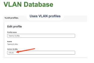

✅ Ensure VLAN DB consistency with VLAN Profiles, making sure the VLANs that you do need are correctly provisioned on switches, at scale

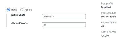

✅ Configure trunk ports to allow all VLANs, the same way MS switches do, while still only having the active VLANs created on the switch.
