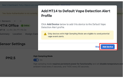

There is a new default potential vape detection alert that is available to help customers set up their MT14s for vape detection as easily as possible! Activate the default potential vape detection alert by toggling the sensor into high sampling mode on the Sensor Settings page.
Once the default vape detection alert is created, future MT14s can be added with one click; no need to scroll to the bottom of the alert config page and hit save.

- Here's a video demo of how to add your MT14 to the default potential vape detection alert:
