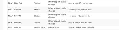

cmr
@pope what do you see in the event log for the reboot, this is now recorded since recent changes and you should see similar to the below where the power lead was pulled as part of some ISP troubleshooting:
