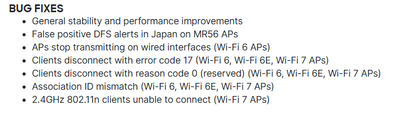

We've had issues with roaming on CW9176 with WPA3 and just got confirmation from Meraki that there is a known issue. Does not seem to affect the CW9172s. I'm not aware of any workarounds other that not using WPA3 on the CW9176. Haven't heard of any ETA on a fix.
n01048
What did Meraki advise you? We are using CW966I’s as we have the issue on WPA2 and 3.
JonM18
They said the issue is only seen on firmware 31.1.7, but we've see in on all previous firmwares.
They're asking if we've seen the issue on 31.1.7.1. We're testing that currently.

We're still seeing the issue on firmware 31.1.7.1. Meraki says its an issue on a "subset" of devices with WPA3 authentication. We're having to turn off WPA3 (and this 6GHz) for any networks with CW9176s.
Also, issue isn't just with roaming. Clients can get disconnected just sitting still.

I like to add that I too have a deployment at a customer with CW9172I AP's and we see the AP's disconnecting clients when their RSSI is around -60 or lower which is wayyyy to early.
I could stand with my back turned to the AP and do amazing speedtests but in between my client got disconnected several times.  The issue does not appear to have anything to do with roaming but since when you roam you are usually at a weaker signal this just happens even causing roams to fail and clients having to rescan channels to regain.
The logs clearly give a reason=reserved and clearly is a crippling bug.
The issue also happens on the FW version that has this issue 'fixed'.
I have also logged a case for this but I first have to get through the initial resistance of the first line support that wants to see my 'surveydata' before proceeding..... <frown>
JonM18
The issue we're seeing appears as an association failure with reason "reserved", auth_mode="wpa3-psk", radio="2". Easy to find the issue under Assurance->Overview->Clients->Wireless->Association.
