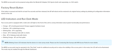

Since it been updated we can't connect to the internet. LED emitting a blinking blue green light.

TBHPTL
Head in the Cloud
Blinking blue green is not a valid LED signal....
https://documentation.meraki.com/MR/MR_Installation_Guides/MR36_Installation_Guide
if going blue then green then blue then green that could indicate a client joining and getting deauthed.  MFP something could be issuing deaths to your clients.
I would make sure the wired connection is good, check it with a laptop and pinhole factory reset the AP and let it update.  You can always check the local status page of the device.
https://documentation.meraki.com/General_Administration/Tools_and_Troubleshooting/Using_the_Cisco_Me...
Still not working open a ticket and let support guide you and then RMA if its not working.
