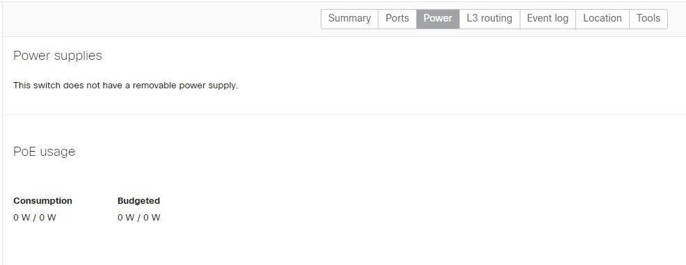

I have a Problem with a switch. All PoE Ports are orange and the message says "PoE port was denied power".
I found another topic here, were the problem was, that there were to many PoE devices on the switch.
But on this one, there is only one AP and one Phone.
Also under the power tab it says:
Any opinions?

This just happened to me. Had an MS225-48LP that was part of a two switch stack deny power to all PoE devices that were plugged into it. When looking at the Power tab, it was showing 0W/0W budgeted and consumed. The other switch in this stack was still OK. A reboot fixed it and when the PoE devices came back online, it was only showing 54W/370W Consumption with 200w/370 Budgeted.
