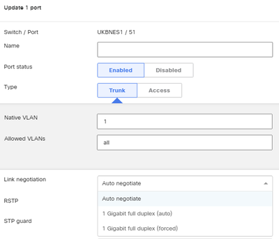

@Mark-SPS I don't believe the SFP+ ports on the 425 will work at anything less than 1Gbps, especially with the Copper transceivers.  The below options are from an MS355X SFP+ port
You might get a 100Mb fibre transceiver to work at that data rate.
