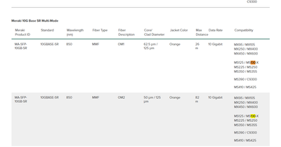

Hi,
On the following meraki documentation:
https://documentation.meraki.com/General_Administration/Cross-Platform_Content/Small-Form_Factor_Plu...
The MS130X does appear on the list of supported devices for the transceiver MA-SFP-10GB-LRM.
Could confirm if this transceiver is suppoted or not on the MS130X platform ?

It's just the MA-SFP-10GB-LR (single mode) that's supported on the MS130X product suite.

This SFP model is not supported on this switch model.
If you filter by Switch model you will see that other SFP models are supported.

I know the document URL I posted does not show the MA-SFP-10GB-LRM as supported. But the Meraki Sizing tool says this MS130X support this transceiver model
https://merakisizing.com/#/ms
That´s why I am asking
It is saying that it supports 10Gb SFP, but not that specific model, it is another SFP model as you can see in the document.

The Meraki sizing tool says that the MA-SFP-10GB-LRM is supported on the MS130X
It's not

I would personally trust the datasheet over the Meraki Sizing tool.
The datasheet is generally considered to be the source of truth while the sizing tool (despite being created by a Meraki employee) is somewhat unknown in terms of its accuracy and guarantees.
Best way to be sure though would be to raise a case and have Meraki support confirm.
