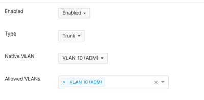

If you define it as a native VLAN on the trunk and tag it at the same time, your problem will be solved. 🙂
Something like this.
NetEngJH
The switch will accept tagged frames and untagged frames on the native VLAN?  What sort of magic is that.
Yes, I configure it this way mainly when I want to test SSIDs on Wifi. So I think it's worth testing it this way.
