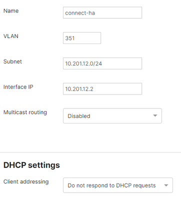

This is my Transit VLAN

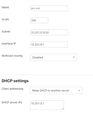

and on the Switch
as an example the VLAN 340 on the switch. As DHCP Relay I have chosen the Transit VLAN

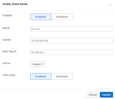

This is my static route on the MX

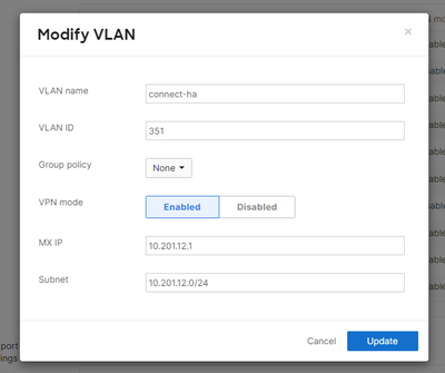

and the DHCP server on the MX
