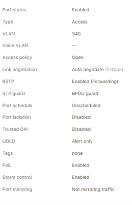

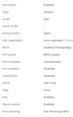

Here is the configuration of the switch ports

this is my configuration for the switchport
