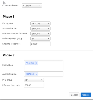

Hi,
I was struggling with the same.
My MX was connected to a LAN port sitting behind my ISP router.
My colleague shared a setting that resolved this issue for my setup.
On my home ISP router, i needed to configure port forwarding towards the internal IP that my MX was using.
500UDP and 4500UDP
And these were the IKEv2 settings on the portal
