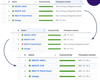

So your upgrade completed, now what? There are two additional “bonus” pieces that work together with firmware upgrade status:
Firmware version column
The firmware version column on the switch list page will also reflect the firmware version status during and after the upgrade. In this fashion, you can see at a network level how an upgrade is progressing, and after the upgrade you can tell whether any individual switch needs additional attention if it wasn’t able to complete the upgrade:
