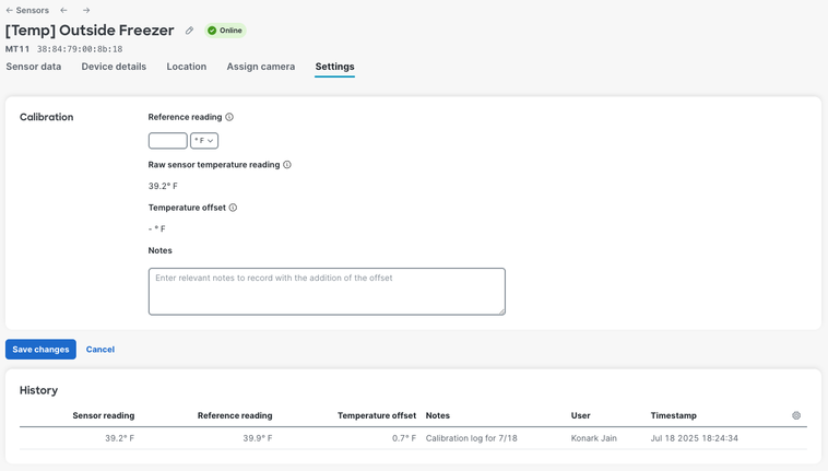

You can now fine-tune your MT11 temperature readings to match any reference temperature sensor. This means more accurate monitoring for your critical applications, whether you're tracking freezer temperatures, server rooms, or any environment where precision matters.

How To Configure Offset
The calibration feature is available now in your MT11 sensor details page under the "Settings" section. Look for the temperature offset field and follow the simple setup process.
Pro tip: Allow up to 20 minutes after saving your settings for the calibration to take effect (that's when your sensor checks in for updates).
