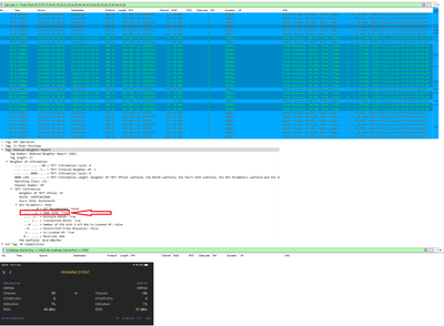

@thomasthomsenI have the following results.
The first screenshot shows the settings before putting the AP into survey mode + the settings in survey mode.
So I put the AP on all three band on the highest ETSI channel (highest PSC on 6 GHz) with a 20 MHz width.
The second screenshot first shows the capture that has been made only on the three channels using the SK2.  It has a display filter limiting only mgmt frames that contains the site_survey SSID.  There you can see that beacons only occur on the 2.4 GHz and 5 GHz.
When looking inside the beacon on both bands I did find the RNR that contains the info about channel 85 with the same SSID.  So technically you would be able to connect to it.
Below that I filtered out frames on the 2.4 and 5 GHz channels and found 0 frames on 6 GHz.

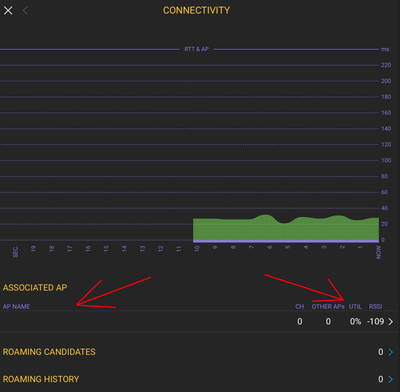

Since I don't have a device that supports 6 GHz outside of the survey Ipad I couldn't capture the connection flow.  Since on the IPad when you start a capture in Ekahau Analyser and you move to another screen like to connect to another SSID the capture stops.  However I was able to connect to the 6 GHz site_survey SSID briefly before the iPad choose to only connect to the 5 GHz version of it.  As you can see in the lowest part of the screenshot.  I believe this has to do with the fact that open SSID's are not allowed on 6 GHz and the site_survey SSID is open instead of enhanced open.
So in short the behavior in site survey mode is quite different from the normal online operation.
No beacons on 6 GHz but there is an RNR on 2.4 and 5 GHz versions of the site_survey SSID and connecting to it is technically possible.  However this is impossible to use for site surveys.  So for the time being if you want to do an AP on a stick survey you will need the AP connected to the cloud since then it actually does send beacons.
