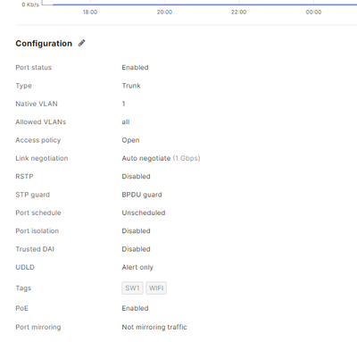

When my customer tried to connect to SSID_corp, he was unable to obtain an IP. Perhaps the reason is  for the vlan 1  which has IP address 192.168.5.2.12, is in vlan 1  he gest APIPA IP 169 .The MX is configured to pass to the Mraki switch as follows:
maybe it ies better to put the port like
drop untuget traffic?
or change the vlan 1 for other
SW AP
On the other hand, the PC connected to the vlan 1 works well. I guess the problem is for vlan native 1

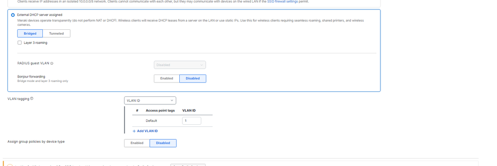

The issue is with vlan 1, and vlan 2 is working fine. I believe the issue is with a native vlan 1
ww

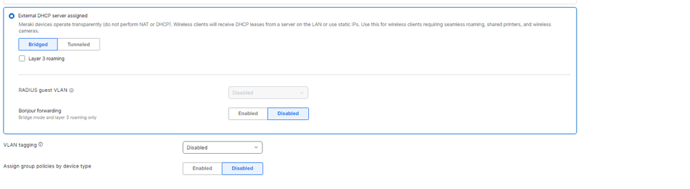

Like @Mloraditch says. Dont set to vlan1. Use vlan tagging: disabled
else you get tagged vlan 1 traffic instead of native vlan traffic.
athan1234
A model citizen

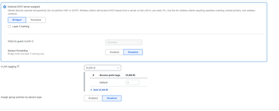

So let me undestand
Now is set up like this :
If i understand weel i need to set up like this:
ww
Yes. If you want to use the native switch port vlan (1).
