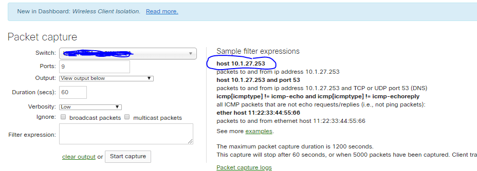

Hi at Switch MS120-48, one port is disconnected sometimes. when we try to run packet capture, it shows some ip address there. can anyone tell where the ip address is coming from? please see the screenshot attached. Thank you
9 Replies 9
BrandonS
That is just an example/sample you have circled there.

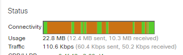

Merakibgp
Yes you are right. I guess it is cable issue and needs to be replaced. please see the screenshot. any other can cause the issue? thanks
BrandonS
Yeah seems likely a bad cable.  You could try replacing patch cables first.  It could also be a bad NIC card or even a bad switch port, but cable seems most likely.
Did you actually run the cable test?  It will report back with specific bad pairs, etc.

BlakeRichardson
Could also be the device has Energy-Efficient Ethernet (EEE)

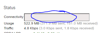

but when checking status history, why it show non color on this box on two hours? please see the below screenshot
and what is that meaning "Could also be the device has Energy-Efficient Ethernet (EEE)" ?
BrechtSchamp
Gray means disconnected. If your port is connected and working well you may have run into a UI bug.

I see the port speed of my desktop PC and my NAS go to 10mbps when they're turned off, the IPMI and WOL features make it do that. I've never seen a port go to orange because of that though.
It may very well be a cable issue (interference, bad contact, too long, ...).

 at the same time point, do not know why it has two different color green and gray? please see the below
above is Historical data for the last 2 hours
BrechtSchamp
Yeah, you may have run into a UI bug. Is the situation still unchanged? Sometimes it takes a moment before the dashboard shows the correct status of port connectivity.
