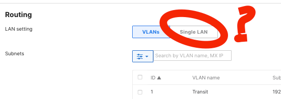

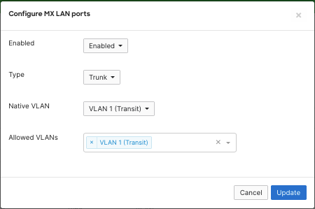

How would you configure the uplinks/Transit VLAN between the MX and Core?
On the MX should I even define VLANs or should we use the default Single LAN ? The Single LAN option shows as VLAN 0, so what should the port settings on the switch side be?

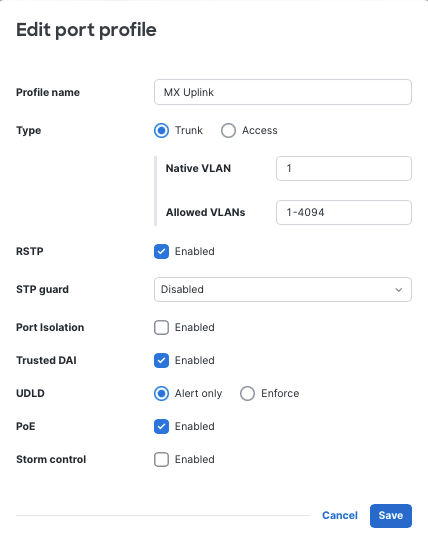

Should I be allowing all VLANs to pass for the Merakis to track clients correctly?
Should I be using Storm Control on the MX uplink ports?

Hi @JackShep , i would configure both sides as Access ports and route between the two devices.  This is described in the link provided above using Vlan 50 and a /29 subnet configured on both the Mx and switch

Thank you, I just noticed that they are using access ports between the MX and the L3 Stack. I had everything using trunk. Wonder if thats part of the problem.
Personally, I always use VLANs.  And even when I use access ports between two devices, I still use the same VLAN number on both sides.
Then I know, no matter what device I am looking at, if I see vlan "x", what the intention or purpose is/was.
