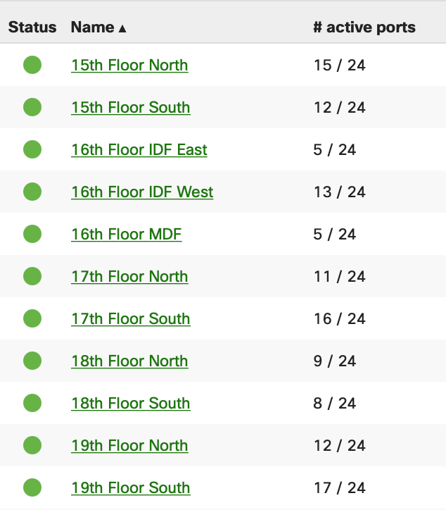

BrandonS
I think the floorpans only work with MRs?  Here is a snip of one building switch names I used that has multiple rooms per floor with switches.  Then on each switch page I put the actual room # in the notes.  The room number can also be found on a floor plan and on the actual door.  This was all installed 5 or so years ago so it is super helpful for a tech to find a switch without wandering through halls and trying various closets, etc 🙂

@BrandonS  Do you give all of your staff a compass incase they lose their bearings 😂 Only joking we have the same thing in one building with access points.
@BlakeRichardson Ha.  This particular building is troublesome as it is federal government and needs security and escorts and can take 30 minutes from arrival just to get inside a room 😉
