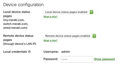

BlakeRichardson
@Mike05  Is local management page access enabled in your dashboard as its something that can be disabled.
Network-wide > Configure > General
Hi @BlakeRichardson ,
Thank you for your response.
I will explore this option, I'm still new in using Meraki Dashboard 🙂
Regards,
Mike
