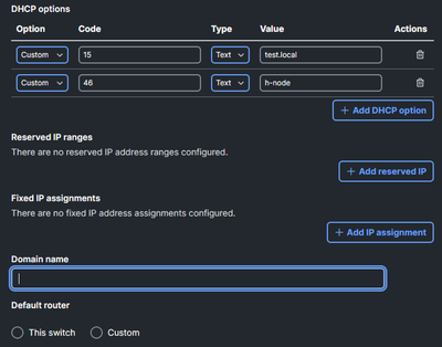

I just tried on a C9300-M. Same error as a MS390.
I don't have any background on why it's not supported. I see several old threads about various IOS versions on routers and switches not supporting either.

Tested and dashboard appears to allow the config for MS (classic Meraki) switches and MX's.

@Ryan_Miles can you please try options 44 and 46 on your C9300-M (netbios-name-server and netbios-node-type) and see if they are allowed?

44 & 46 not supported (presents error) on MS390/C9300-M.
119 appears to be supported.

Thanks @Ryan_Miles, so it seems that you cannot use the options that are named in IOS-XE as opposed to the ones where IOS-XE needs the option number.  Can this please be logged as a high priority bug as it does somewhat damage the Meraki switch product path!?!
