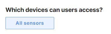

On the site where we have both MT and MV's, I created a role to access sensors only, but was unable to select which sensors as the screen below did not list the sensors to select (i.e. I cannot give the role access to specific sensors only - EG MT11's, not MT10's)
When hovvering the mouse over the "All Sensors" box, it cannot be changed, so how do you select specific sensors/models?
