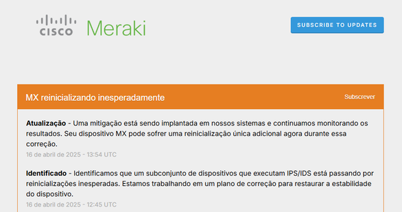

Hey Folks,
As per the update on status.meraki.net , we are now seeing restoration of the service.
If you are still experiencing issues, please do reach out to Meraki Support.
Thank you so much for bearing with us during this disruption.
Giac

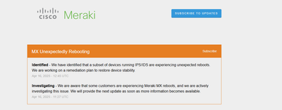

Graham_W
This is affecting us across multiple sites but why do you not have anything of your status page. Cisco / Meraki this is poor to say the least.
SamerAl
Meraki Employee All-Star
Hi All,
Please check the meraki status page for any updates regarding this issue :
Thanks
If you found this post helpful, please give it kudos. If my answer solved your problem, click "accept as solution " so that others can benefit from it.
GiacomoS
Hey folks,
status.meraki.net has been updated and reflective of the incident.
Giac
Please keep in mind that what I post here is my personal knowledge and opinion. Don't take anything I say for the Holy Grail, but try and see!
Appreciate who helps and be respectful of every opinion and every solution offered.
Share the love, especially the Meraki one!

Bertolo
Por aqui parece que estabilizou a conexão.
Meraki Status
Bertolo
