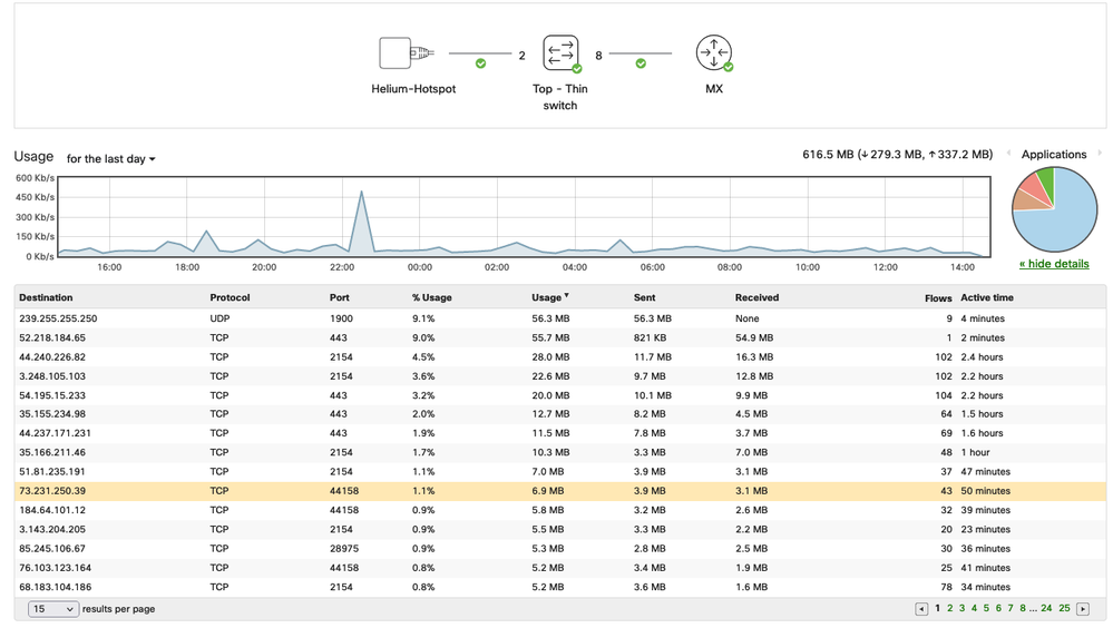

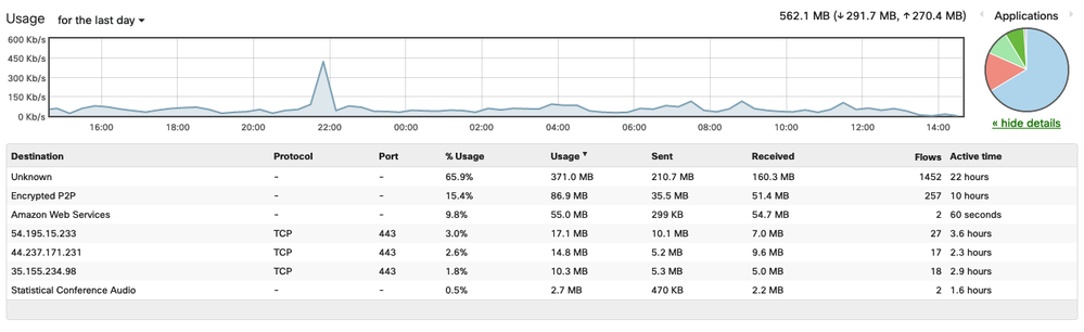

I finally got the ones I purchased back in November last year and added them to my Meraki networks. Helium asks you to allow outgoing connections to 443 and 22 and to open port 44158 for the miner work correctly. Both My Meraki networks identified the device correctly as a Helium-Hotspot.
This one is connected via WiFi with no port forwarding
 This one was setup wired and has the correct port forwarding enabled (DMZ for this guy) and I see a whole lot more connections going through it (sadly it is a MUCH slower pipe connecting it so not much more data)
The above is correct, if you disallow mining in the content filter, it stopped it from reaching the cloud.
