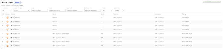

On the DC MX, the route table has both the "Meraki VPN: VLAN" and "Internal BGP" for a specific Spoke network installed in its routing table. This just seems strange to me. Whats "worse" (Depending on your definition here) is that it seems that "stat" for 2 out of 4 networks are green for the iBGP route, and the other 2 are green for the "Meraki VPN: VLAN". This is really confusing "pick a lane" 🙂 (see attached picture of the route table for the DC MX for one of the spokes)
If someone could explain this behaviour ... it would be great 🙂

3, the route table always have been a mess. Especially with bgp
