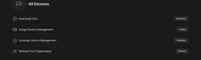

If you go into ASM you just need to go to the devices tab on the left side and then in the search paste in the serial numbers which will generate a list. Once you have that list you can select all devices and then you get the management for those devices.
If you are e-wasting them I would assume you'd want to Release from Organization which will remove them from ADE in Meraki the next time you update it. You want to make the changes in ASM as those will be pushed into Meraki.

You can also "disown" them directly from SM:
Go to Systems Manager > ADE
Select the devices, and click Disown:
https://support.apple.com/guide/apple-business-manager/release-devices-axmec4d28461/web

What @vassallon said the ABM/ASM devices page is smart enough to know you have pasted a lots of serial numbers in and will automatically add commas.
