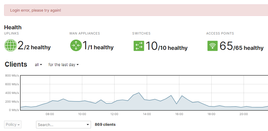

I can tell that the system knows my login is validated because it doesn't ask me for an MFA code when I sign in, but takes me straight to my client list. However, the following pink bar is displayed across the top of the Dashboard...
Not sure why there is an error, and definitely not sure why I need to "try again", as I have clearly been signed in correctly and can access my organization.
