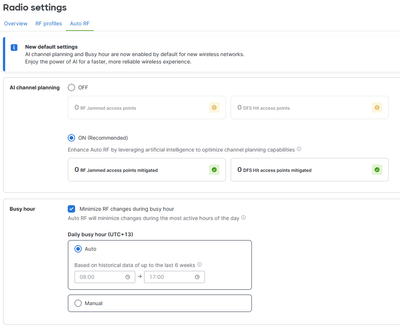

If you haven't got it enabled - trying enabling AI channel planning as well.
