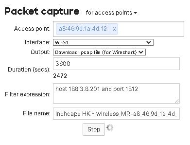

You didn't need the host , only radius communicates on that port.
If your AP does not send anything when the client connects to it (so be sure it is a new session, not a roam) then the AP is not doing anything towards the radius servers.
Another important note though:  Dashboard captures can be a bit finnicky and it is possible your capture stopped capturing packets a long time ago.  It is best if you use dashboard captures that you keep to the 30 seconds to 60 seconds mark and immediately try to connect.

i will try to do data packet capture on meraki dashboard, may i share it out the capture result and guide me how to check the issue in the logs ?
RaphaelL
Yes you may. Just be careful not including sensitive trafic in the packet capture

Download the pcap file and load it up in Wireshark.

below are the packet capture

GIdenJoe
That's the wireless capture which will not reveal the radius communication.  You have to change the capture interface to wired for that 😉
Also when you want to capture the radius communication on the wired port please use following capture filter: port 1812
The reason your AP can't get a response from the radius could be because it received another IP address from DHCP?  Each AP individually is a radius client.
Keith_Li
i did the following capture, after completed, i couldnt find any data related with port 1812, shall i upload it and you can take a look for me ?
GIdenJoe
