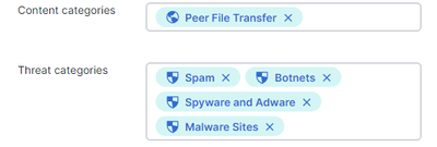

copelj
That's all we have in the category blocking.  I'll add the mzstatic.com though, just in case.  Thanks!!
