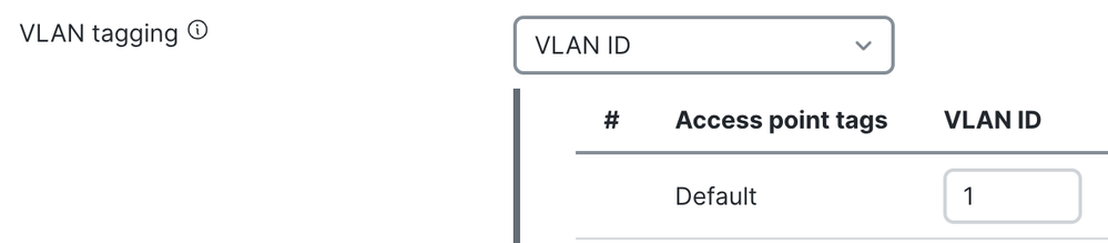

Don't tag your native VLAN on the SSID.
If you want clients of the SSID to be on VLAN 1 then either tag the switchport (MX LAN port in your case) to something other than 1. Or, on the SSID disabled tagging and clients will then be put onto the native VLAN of the LAN port.

Since I want to run multiple ssids each in a separate VLAN, I assume the first of your two suggestions is the way to go?
By the way, just out of curiosity, I'm wondering why the default for the lan port couldn't be the same?
Any going to try later today. Thanks
RayR
Changed mx lan port to. "Drop untagged traffic" and now that works fine - THANKS
