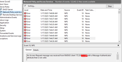

Hi ,
Share with you error messaging pop up time to time on NPS logs. Any idea  !!
Mloraditch
A quick google says this usually means the shared secret is mistyped somewhere whether in the Dashboard or on NPS. As you only type it once on the dashboard for all devices (per policy/ssid) and you say some authentications are working I'd check your NPS clients in NPS.
