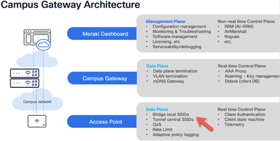

Well, from my point of view, MCG solves the challenges that arise in large campuses or deployments with multiple buildings, where Meraki access points need centralized tunnel termination for traffic, instead of sending everything directly to the internet, consistent application of policies across multiple VLANs and SSIDs, and segmentation and security without relying on complex Layer 3 designs or distributed firewalls.

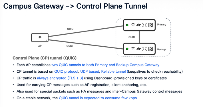

Not 100% sure about the "different network" part of the question but the next slide that you referenced shows:
Each AP establishes
two QUIC tunnels to both Primary and Backup Campus Gateway
This statement is true for the Control Plane, but not for the Data Plane.
An AP can maintain control plane connectivity to two MCGs simultaneously (Primary + Backup), data plane tunnels are still single-homed—traffic flows through only one gateway at a time.
The dual control plane tunnels are for redundancy and HA, not for segmentation or active-active forwarding.

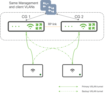

Taken from the Campus Gateway Deployment Guide.
https://documentation.meraki.com/Wireless/Design_and_Configure/Deployment_Guides/Campus_Gateway_Depl...
“Active-Active clustering will be automatically configured by Dashboard whenever there are two Campus Gateways in to cluster. The members of a cluster will also be configured as mobility peers, so clients will be able to roam across APs tunneling to different primary Campus Gateways in the cluster seamlessly.”
