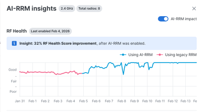

Have you looked at your AI-RRM Insight stats ?
Wireless -> Radio Settings :
RaphaelL

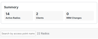

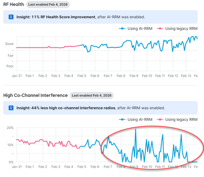

I have AI-RRM , FRA , AI Channel planning and Busy hour configured on 15 networks to do a PoC.
Each network has between 6-22 APs in normal open office environnement.
FRA seems to be super agressive on some sites.
More than 1/3 of the radios are disabled on this network.
The stats ( made by the tool ) looks okay , but you do see a big swing in score everyday. There are a lot of channel changes and Tx power changes. Way more frequently than before.  I'm still in the 14 days training period , I hope it will become less agressive in the future.
