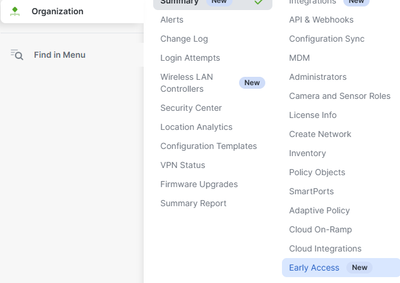

While MS switches have no concept of a VLAN database, you can have a VLAN database in the dashboard using the "Named VLANs" feature.  You might want to enable this to make it easier for yourself.
https://documentation.meraki.com/MS/Port_and_VLAN_Configuration/Named_VLANs_in_MS_Configurations
You can enabled named VLANs under the "Early Access" part of the Meraki Dashboard.
