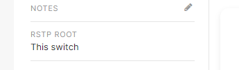

Dear All,
We want to make catalyst switch(Core) below as an RSTP root primary and secondary for several MS switches under the Core :
We have already state the all the MS switch RSTP priority to the maximum value of 61140
but, it seems the root switch still on each MS
is there any approaches to move the RSTP root to the Catalyst Core Switch, below a brief config on catalyst
glad to hear any response from you all

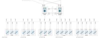

so, with this topology below
MX1-MX2
CAT1-CAT2
   MS125
we should set MSTP between 2 CATALYST (CAT1 & CAT2) setup the CAT1 as root & CAT2 as secondary root..
meanwhile on the MS125, just config RSTP with highest number priority available, so the forwarding path will be
CAT1-CAT2
MS125-CAT1
and the blocking path will be
MS125-CAT2
is my understanding of the concept correct?

meraki-newbie
It works
the root bridge of MS125 is our Catalyst C3850 core..
we set up MSTP between C3850 ..
Core 1 MSTP priority 4096
Core 2 MSTP priority 8192
All MS125 RSTP priority 61140
thanks all..
