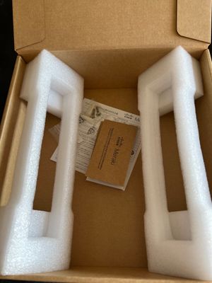

So that for MS120-8FP it does not contain1u rack mount kit in the box ? If I need one it has to purchase separately ?
KarstenI
Yes:
