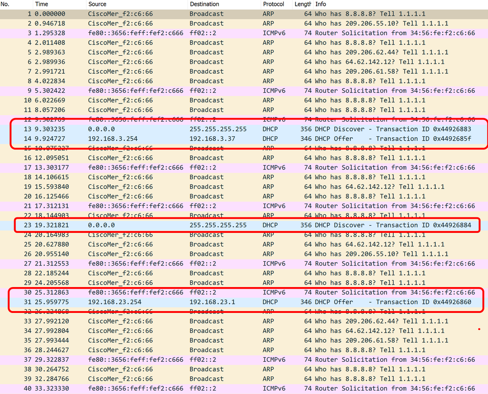

I did a wireshark capture and both switches are arping 8.8.8.8   and getting no where.....

Snap156.pngDoing a wire shark capture using the MAC address of the switch  you can see it making DHCP requests on native vlan and other vlan and getting responses  !

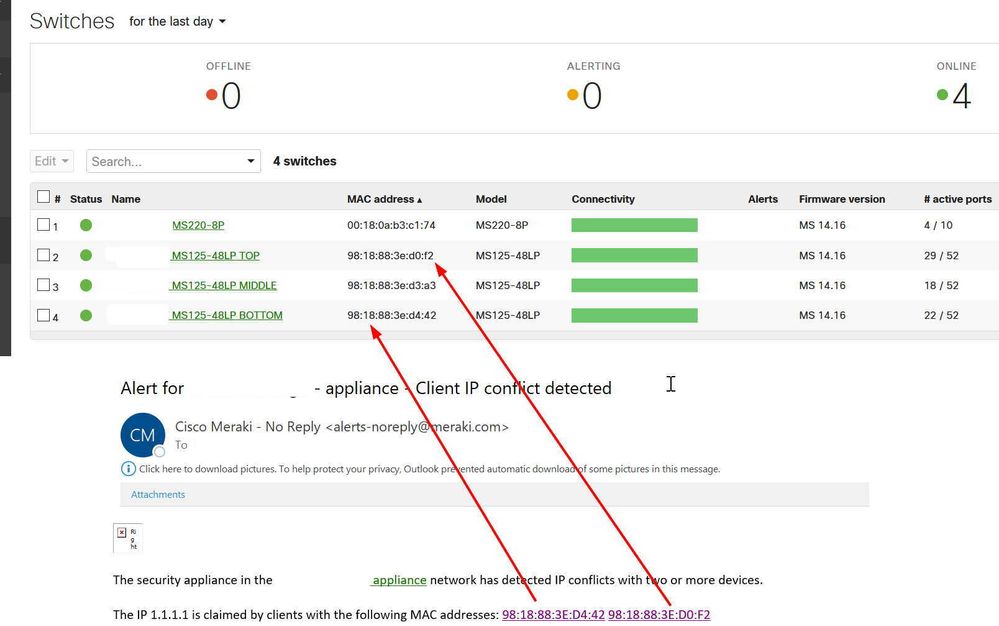

I just upgraded my office switches to 14.16  and got a duplicate IP 1.1.1.1  alert  when doing it.   do the switches boot with address of 1.1.1.1 ???   something wierd is going on here.  anyone else getting 1.1.1.1 duplicate ip alerts ??Snap.jpg

@DHAnderson I think he has MS125s, look at the screenshot of them with the red arrows on.
