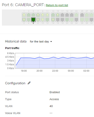

VLAN 0 -
I see a bunch of clients showing they are on VLAN 0, but I don't really know what this means.
For example:
Shows it on port 6, but that is configured for VLAN 40.

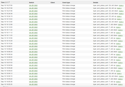

Also seeing constant port status changes, so I am concerned to know if this STP root message is truly something to be concerned about or a bug.
Or is it just an MS390 thing?
