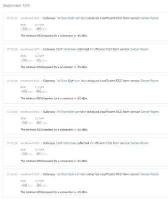

I think it wants better than -85. As for the obvious things. What model AP’s and what firmware version are they running?

Thanks @Ryan_Miles I saw these in the event log that support your statement:
However the sensor can see four APs that are all MR42s running 28.4 and one of them has a -67dBm signal
