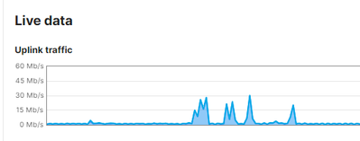

That's weird...  When you do the test , do you see the same usage in Appliance Status -> Uplink ->Live data
The speed test from Insight is reliable , but I would confirm with a PC directly connected to your WAN and run a speedtest from any speed test website.
Baam
Thank you for the suggestions. it turns out weird. both speeds does not match.
is it a bug or got another explanation here?
