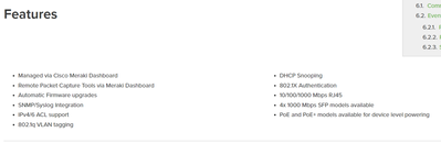

That would be great but we cannot get a Layer 3 switch!  We only have MS120's

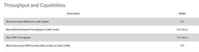

As for the issue of limitations regarding the MX84, in fact what may be the limiting factor is the number of clients on the network, as there is a maximum number of clients supported.

I did not realize the max clients of an MX 84 but it seems to be ok.

It does not have L3 function.
cmr
It does do L3 routing (up to 16 interfaces), but does not act as a DHCP server.  However @Jacob1701 said that they have MS120s, so for the design I suggested, it is the cheapest upgrade.
I'm sorry @cmr, I believe you are confusing with MS210, the MS120 is only L2 does not have L3 functionality.
cmr
No worries, I think we are confusing each other!  I meant that L3 applies to this comment:
Ideally have a pair of MS210s or better as the 'core'.
