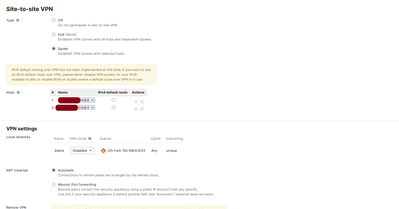

I'm not sure how I'm supposed to set up the MX template for my centers.
The concept is that my client has a renge 192.168.x.0/24. The third digit is changed across the centers
The center are on spoke
When my customer needs to add a new center, I am able to change the third octet of the network's third octet of the IP addres?, I try to comprehend the vlan unique templete. I'm not sure whether I configured the correctly
I don't comprehend /25.

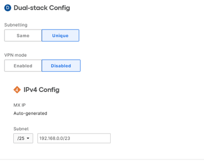

Think of it this way, if you change the subnet to /24 p and set the subnet to /23 as in your example, what will happen is the following, you are saying that the /23 is being split into a /24 when you add a device to the tamplate will automatically provision a random /24 subnet for the device. You can also split this /23 into smaller subnets like /25, /26, /27, etc.
I don't know if you understand? Take a look at the documentation.

josejmto
I'm in a mess. Consider that my customer installed a new center and specified the IP address 192.168.54.0/24. what is the current situation in my configuration? The third octec has been assigned by the customer in each center.
Well, considering that you defined a /23 to be splited into /25 if you calculate 25 - 23 = 2, then 2 raised to 2 will make it possible to create a maximum of 4 /25 subnets.
There is no way my friend, if you want a /24 you will have to reconfigure the network in the template.
Do you have expertise with subnet calculation?
You want to specify the subnet to be a /24, and that it is allocated out of 192.168.0.0/16.
