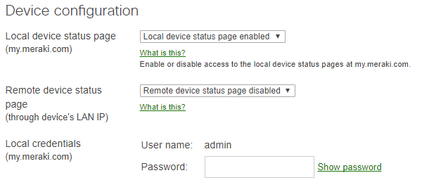

Go to Network-wide -> General on the Meraki Dashboard. About halfway down you will find the ‘Device Configuration’ section, under that section are the local credentials. The username is ‘admin’ and you can set the password there.
If the device is connecting to the Meraki cloud it will use the username and password configured here. If the device has never connected to the Meraki cloud (or if you do a factory reset and keep is disconnected) then it will use the serial number as the username, with a blank password.
