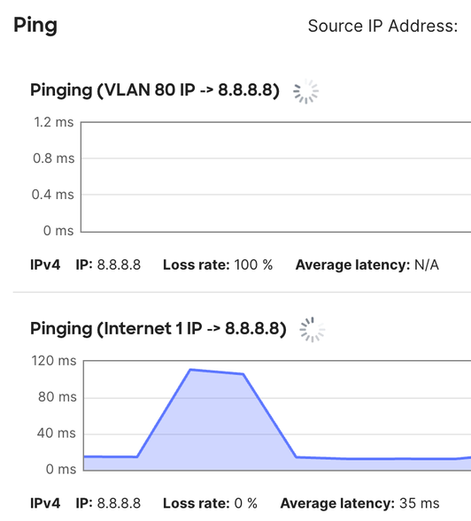

The problem is that when i take this network out of AutoVPN (set that specific network to disabled) and try to ping from the MX (source "the internet only VLAN") I see these packets on the central HUB MX (in a packet capture).
I have NO idea why, this should not happen right ?
Or is this because I use the MX status page to test out connectivity (some random issue no-one was aware of).
Just wondering.
Or have I missed something ?
