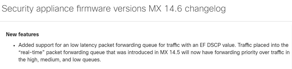

But, for inside your own network, what @NolanHerring says is bang on. Well... Almost bang on, depending on what version of firmware you're running. As of version 14.5:
And then tweaked just a touch in version 14.6:
In our testing this has worked exactly as described. So at the end of the day, for Voice payload, as long as your end points are marking their traffic correctly and your switches trust those markings (or if you're marking on switch port ingress) you don't actually need to do anything on the MX. It's already doing it.

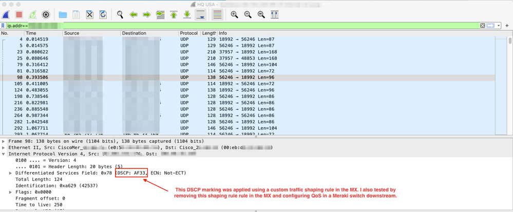

Hi all,
I had a customer asking if the MX units copied DSCP markings from the unencrypted IP header to the encrypted UDP packet header. I was happy to find this discussion with some saying yes, and some others saying no. I took the time to set a little lab and I was even happier to see by myself that DSCP tags ARE copied from both already marked traffic ingressing the MX, and traffic that is marked by a custom traffic shaping rule in the MX. I could see the DSCP field with the corresponding class on the encrypted UDP packet in a packet capture.
Mystery solved 🙂

@CarlosRu Great to know for certain. This is supported by the FAQ at the end of this article, https://documentation.meraki.com/Architectures_and_Best_Practices/Cisco_Meraki_Best_Practice_Design/.... Out of interest, what firmware version did you use in your test?
CarlosRu
Hi @Bruce
I thought I had included the firmware version in my post. I pushed the latest stable as of Oct 2 2020 which is MX14.53.
Thanks for the tip about the FAQ reference. I was hoping that they had this documented somewhere.

DennisSN
i did the exact same test today, and ALL traffic between my branch MX and HQ VPN hub is CS0
Both devices are on firmware 14.53

GIdenJoe
If your inner traffic is not tagged, your outer traffic will not be tagged to.
Please make a capture on the final switch right before the packet enters the LAN interface of the MX.
Or make sure you have rules in place to tag the packets at the MX.
